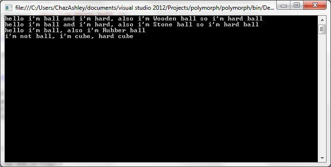

не розумію, навіщо мені це -_-
using System;
namespace polymorph
    class Program
        static void Main(string[] args)
            Ball[] balls=new Ball[3];
            balls[0]=new WoodenBall();
            balls[1]=new StoneBall();
            balls[2]=new RubberBall();
            foreach (var ball in balls)
                ball.AbstractBallSay();
            HardObject hardObject=new IronCube();
            hardObject.HardObjectSay();
            Console.Read();
    abstract class Ball
        public void BallSay()
            Console.Write("hello i'm ball");
        public abstract void AbstractBallSay();
    interface HardObject
        void HardObjectSay();
    abstract class HardBall : Ball, HardObject
        public void HardObjectSay()
            Console.Write(" and i'm hard");
        public override void AbstractBallSay()
            BallSay();
            HardObjectSay();
        public abstract void HardBallSay();
    class RubberBall : Ball
        public void RubberBallSay()
            Console.WriteLine(", also i'm Rubber ball");
            BallSay();
            RubberBallSay();
    class WoodenBall : HardBall
        public void WoodenBallSay()
            Console.Write(", also i'm Wooden ball ");
        public override void HardBallSay()
            Console.WriteLine("so i'm hard ball");
            BallSay();
            HardObjectSay();
            WoodenBallSay();
            HardBallSay();
    class StoneBall : HardBall
        public void StoneBallSay()
            Console.Write(", also i'm Stone ball ");
            BallSay();
            HardObjectSay();
            StoneBallSay();
            HardBallSay();
    class IronCube : HardObject
            Console.WriteLine("i'm not ball, i'm cube, hard cube");
