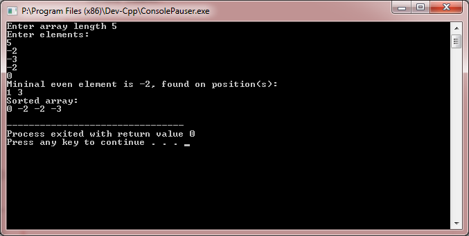

Для любителів користувати sort замість сортувати вручну:
Код
#include <algorithm>
#include <vector>
#include <functional>
bool isEven ( int number )
    return number % 2 == 0;
bool isNonPositive ( int number )
    return number <= 0;
  unsigned nElements;
    cout << "Enter array length ";
    cin >> nElements;
  vector< int > array(nElements);
  cout << "Enter elements:" << endl;
  generate( array.begin(),
              array.end(),
                        [] () -> int {
                            int number;
                            cin >> number;
                            return number;
  vector< int > evenElements( count_if( array.begin(), array.end(), isEven) );
    if( evenElements.size() )
      copy_if( array.begin(), array.end(), evenElements.begin(), isEven );
      int min = *min_element( evenElements.begin(), evenElements.end() );
      cout << "Mininal even element is "
             << min
                 << ", found on position(s):" << endl;
    unsigned index=0;
    for_each( array.begin(),
                  array.end(),
                  [min, &index] (int number ) {
                              if( number == min ) cout << index << " ";
                              ++index;
    cout << "No even elements found";
  vector< int > nonPositiveElements( count_if( array.begin(), array.end(), isNonPositive) );
  if( nonPositiveElements.size() )
      copy_if( array.begin(), array.end(), nonPositiveElements.begin(), isNonPositive );
        sort( nonPositiveElements.begin(), nonPositiveElements.end(), greater< int >() );
    cout << endl << "Sorted array:" << endl;
    for_each( nonPositiveElements.begin(),
                [] (int number) {
                            cout << number << " ";
    cout << "No non-positive elements found";
    cout << endl;
Результат
http://replace.org.ua/misc.php?action=pun_attachment&amp;item=216&amp;download=0
Подякували: incred1
